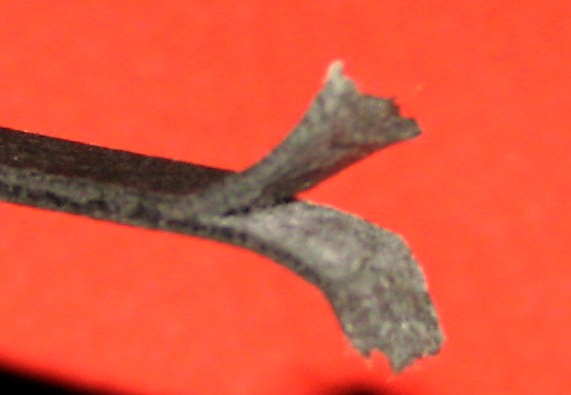

I'm also curious if the stuff I got from Grizzly is the same as the stuff you are talking about.  It sure seems to be laminated from sheets as opposed homogenous.  See photo.

Also, as far as de-laminating...the stuff you showed was probably not vulcanized. Look for the good stuff!
